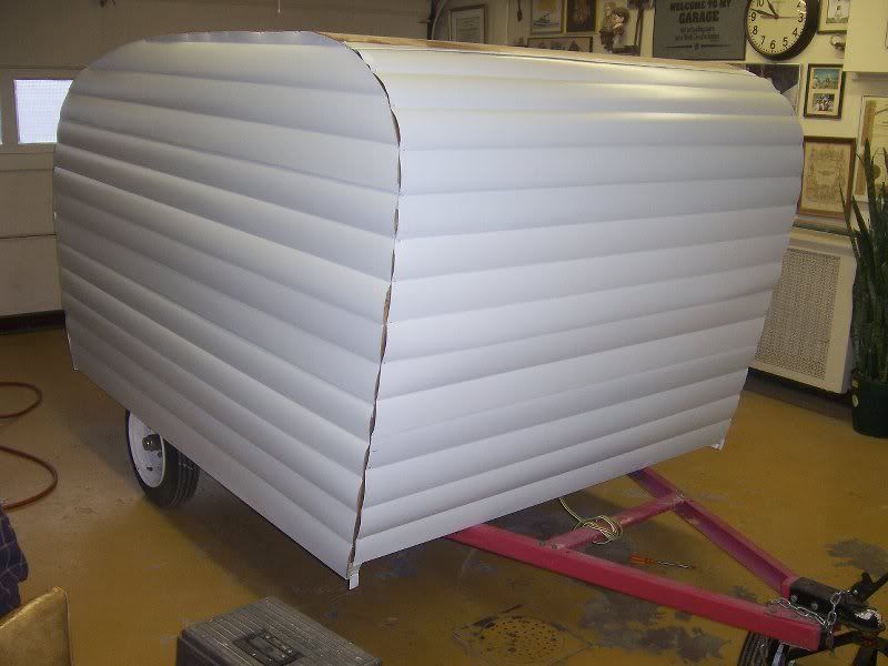

Postby Creamcracker » Wed Jul 22, 2009 6:11 am
And here it is with a white finish and a red insert:
