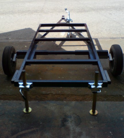

Postby S. Heisley » Wed Jul 22, 2009 11:39 pm
Here's a couple of 'em :thumbsup: :

Postby aggie79 » Thu Jul 23, 2009 8:10 am
Very nice! That camper frame was a nice find. Keep posting pictures.
Postby kennyrayandersen » Fri Jul 24, 2009 3:33 am
looks like a torsion axle and everthing! :thumbsup:

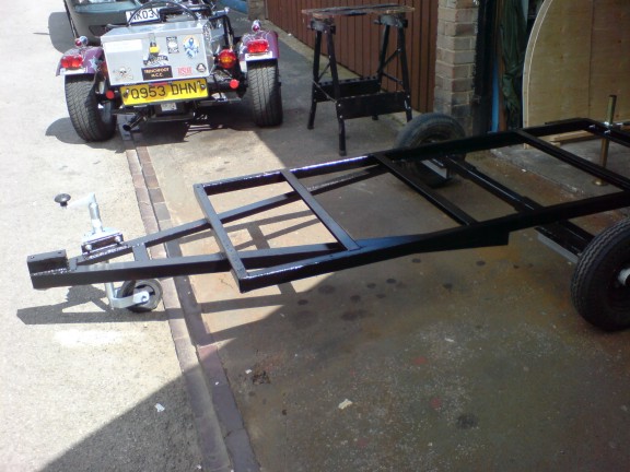

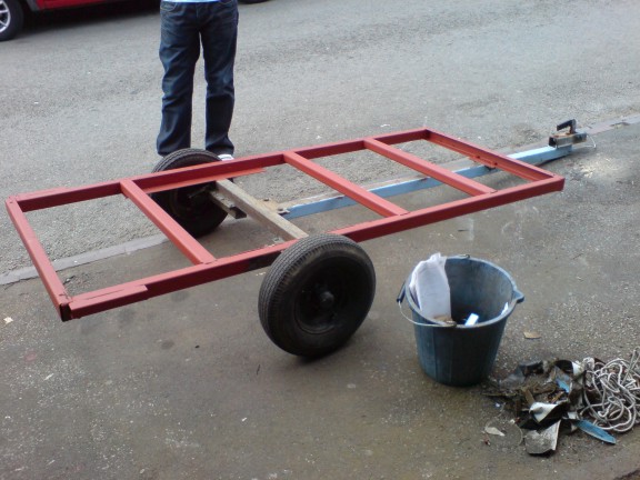

Postby thewhinge » Fri Jul 24, 2009 1:15 pm
The chassis was a good buy, the bearings are ok the indispension units are as good as new, i have had to extend the axle as the chassis is 3ft wide & my floor is 4ft so the wheels were too close, i also replaced the hitch.
I will hopefully post some pics of the finished chassis soon.

Postby thewhinge » Fri Jul 24, 2009 5:13 pm
that makes 2 newb's then !. the size of the trailer chassis is 6 foot x 3 foot
as my floor size is 6' 6" x 4', so i am using 3/4" ply for the floor to make sure it will be strong enough where it overhangs the chassis.
like i said i am also new to this so time will tell if it works out ok,

Postby thewhinge » Mon Jul 27, 2009 1:15 am
Well got the chassis finished during the week, also the floor so its time to start on the rest of the build, weather permitting !
i have a few more things to finish marking up on the walls, once thats done they will be ready to attach.

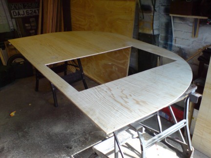

Postby thewhinge » Mon Jul 27, 2009 6:53 pm
thewhinge
Posts: 20
Images: 24
Joined: Sun Jun 07, 2009 7:50 pm
Location: durham england

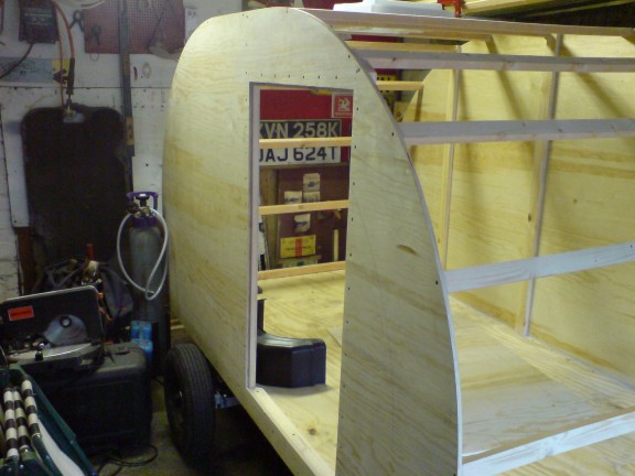

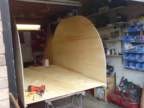

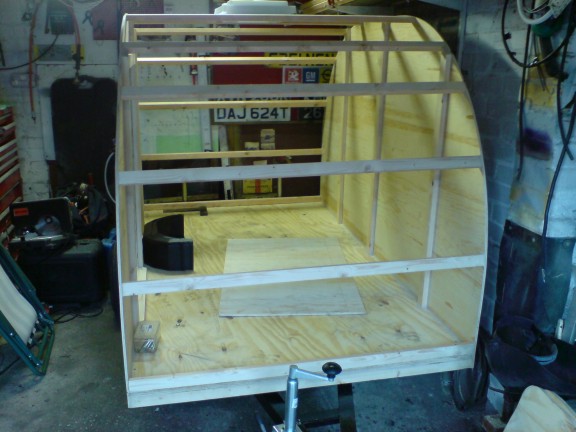

Postby thewhinge » Wed Jul 29, 2009 6:50 pm
Well the project is starting to take shape, i am not bothering with the kitchen as i will only be using it for bike rallies so i prefer to have as much space inside as possible.
New pics in album
i have started on the storage side of things inside & i'm toying with the idea of a single raised bed as i will be using it just for myself, anyone got any ideas on this ?
