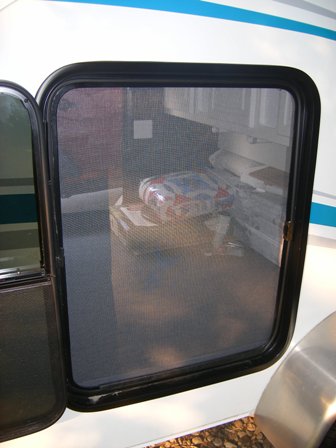

Postby trailtrekerNJ » Sun Aug 02, 2009 4:53 pm
Used the teardrop in Myrtle Beach, SC.....needless to say VERY hot.
My TD is the basic Little Guy, no DC power, no AC, just an extension cord to run the coffee pot.
The door/window leaves little to desire for ventilation while closed.
So does any one have info / idea / design for a full door opening screen? Is it possible to buy screening, sew velcro onto it and use it that way?
Al

Postby trailtrekerNJ » Tue Aug 04, 2009 6:05 pm
The velcro idea works, but after putting up / taking down the screen I think this will eventually wear out the carpeting at the point of contact.
I posted pics on my album.....
I used 1/8" x 3/4" strip metal, cut to length and screwed to wall around door frame.
I found 1/2" wide magnetic strip which I cut to the same length of the metal.
The nylon screening is cut larger for now. I will form a pocket at the top to slide the magnetic strip into. The sides will be folded and glued for neatness and the magnetic strip attached on top of screen. The bottom can be tucked between the mattress and the side of the camper.
trailtrekerNJ
Posts: 67
Images: 86
Joined: Sat Dec 06, 2008 7:52 pm
Location: Old Bridge, NJ
Postby Oasis Maker » Tue Aug 04, 2009 6:31 pm
trailtrekerNJ wrote:The velcro idea works, but after putting up / taking down the screen I think this will eventually wear out the carpeting at the point of contact.
Hey, alright! Looks good! :applause: Whether magnets or velcro, that's keeping it simple and easy. Nice job. One thing, I wouldn't tuck the screen under the mattress, it can be a pain to locate (especially at night) and when tucking it back under you can yank it right off of wall. I keep a small lip on top of the mattress to grab hold of from the inside. The side velcro or magnets will keep it taught. Then as I re-enter the tear backwards, my butt pushes the screen open.
