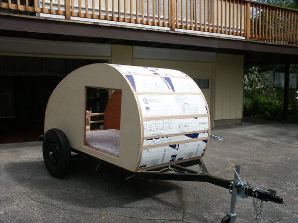

Gerdo wrote:I am in the planing stage of my first Tear. I will start with the Comet and modify from there. Is a 4' wide Tear wide enough? Or should I think about 4'6" or 5'?
Most of the original teardrops were 4'wide, including my 37 Thims. So far the distance between my outer walls is 47 7/8" I've allowed for up to 1/16" (.0625") thick aluminum sheet when I get to the point of skinning the trailer with aluminum, and still allow me to use 4'wide aluminum on the roof. For the time being the trailer will be painted only.
.Image
With that said, many people on this forum are building their trailers to larger dimensions to suit their own needs. It really depends on your own personal preferences for the size trailer you want.
