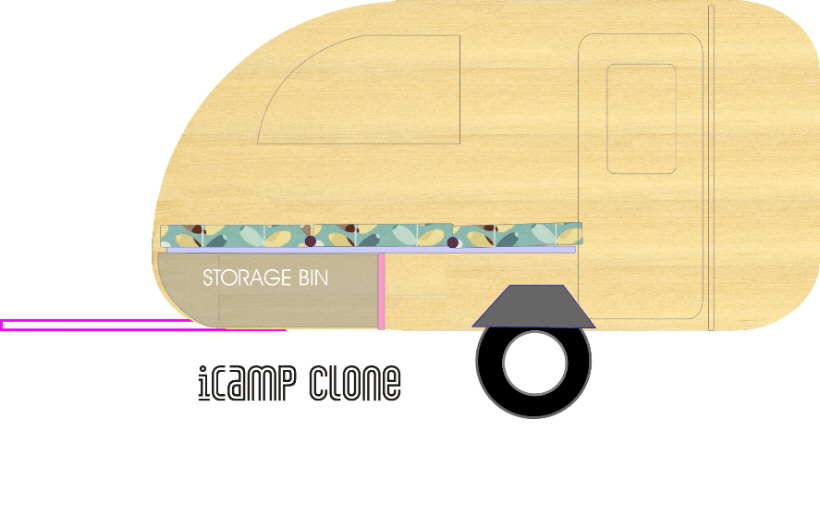

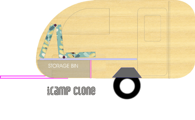

Postby mallymal » Tue Aug 18, 2009 5:47 pm
After WAY too long lurking, scheming & designing, I was worried my design was dead in the water, as Mrs Mallymal couldn't get her head round the concept of climbing through a small door into a bed at "floor level"
She also said "How the heck can I sit on the end of my bed to fasten my shoes"?
So I think a raised bed is the only way round these objections.
I have an early concept i've done loosely based on the icamp shape, but sized to excactly 5 x 10.
it will use 3 slatted bed bases, hinged, so they can "concertina" up to form a widthways bench seat, or can pull out flat to form a 2m long bed.
A low level bulkhead across (shaded pink in the drawing) will form an underseat storage bin. To access this, just flip up the seat squab.
In bed mode, the slatted bases will rest on rails fixed to either side wall (shaded pale blue).
No dining table, but maybe a couple of little drop down/flip up side tables for a cup or coffee etc.
Can't really call it a standy, as I'm 6'4"... more of a crouchy... but I think it might answer mrs mallymal's concerns, and I thought i'd post it here, in case it helps anyone pondering a raised bed.....
Although much too big for a tear, you can see slatted hinged bed bases in this commercially produced trailer from Germany
http://www.deseo-caravan.de/_video/deseo-technik-mov-dsl.html
