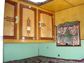

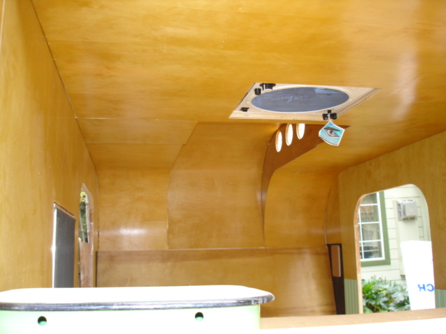

I've had really good luck with the medium yellow aniline dye from Woodworkers Supply. I use the water based stuff. If the paneling is installed, you can get one of those dishwasher sponge things with the handle that can hold soap. Fill it with dye and mop it on.
What's nice is that it comes as a powder and you can make it as intense as you want. It blends nicely if you do a final wipe down with a damp cloth. Hit it with some fine sandpaper to get the little hairs off since it will raise them prior to finish application and between coats. If you decide to make it darker...do another coat, too much...wipe it down again with a damp cloth, it's very forgiving. Experiment with the color you want. Also...make sure that you get paneling that is all fairly equal in color. Darker sheets, will of course show darker. Not the best pic, but gives you an idea of it. Just what I did. Doug
see the difference on the doors....different sheet of goods
Pre trim and molding pic.
