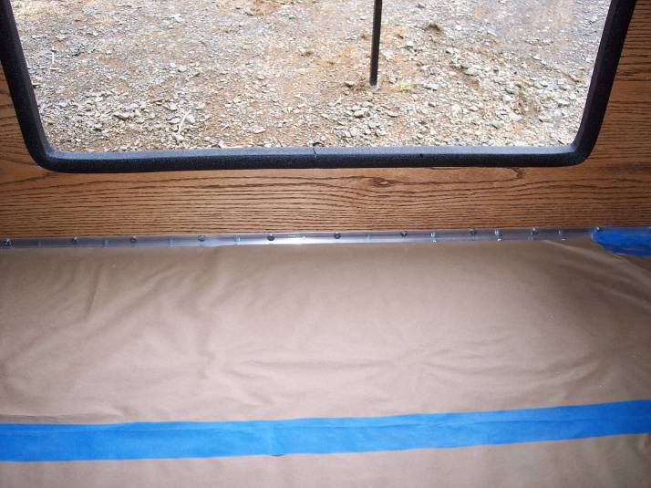

Postby norm's tear drop » Tue Aug 18, 2009 9:35 pm
here is best pic i have of that
get your deck ready and vinyl down
i used a alluminum L channel bought at depot 1/2 x1/2
attach to wall and Imagefloor when you have wall exactly were you want it
norm's tear drop
