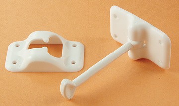

How the heck do I install this RV Door Holder?
Postby KevinS » Sat Aug 15, 2009 11:16 am
I can't seem to find a picture of this RV Door Holder installed. :o
There are no dadgum instructions on the package.
Was is the 'correct' way to install this, please. :thinking:
Thanks!

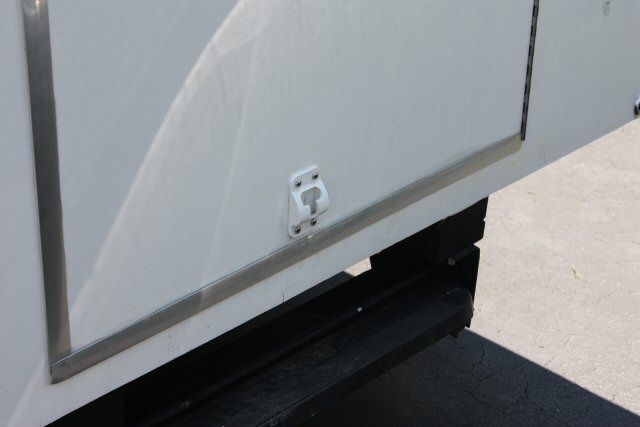

Postby High Desert » Sat Aug 15, 2009 11:24 am
The small piece with the T shaped cutout part goes on with the wide on the top, so the little rod from the opposing piece drops into it and locks into place.
Usually I see them with the small piece on the door and the rod part on the wall. Hope that helps. Good luck!

Postby mikeschn » Sat Aug 15, 2009 12:01 pm
Here's how I do it...
Postby High Desert » Sat Aug 15, 2009 3:27 pm
there you have it- pictures beat 1000 words everytime :lol:
