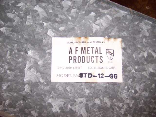

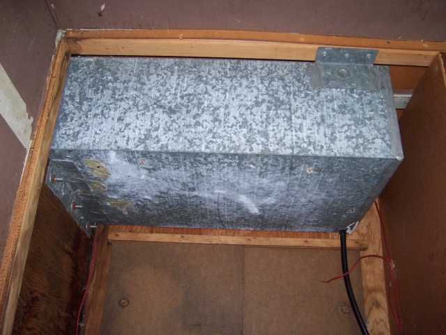

Water Tank has holes and is full of rust so Im looking for another tank. It is 24x15x8 and has 3 mounting flanges that hold it to the top of the tear. Here is a pic of the tag on it and one of the tank out of the tear. Where can I find the colsest replacement to this?

Maybe something like this?

Postby 48Rob » Mon Aug 17, 2009 7:04 pm
Cave man,
It appears from your pictures that you could fit a 10" wide tank in the general area where your current 8" tank is located.
If so, the following link may be of help.
Rob
link to new tank

Postby 48Rob » Tue Aug 18, 2009 6:41 am
Gravity feed will work just fine if you do two things;
1, Mount the tank outlet higher than the faucet.
2, You have a vent at the top of the tank so air can replace the water as it is drained.
16 gallons is a lot of weight to put up high...if you plan carefully for the added stress, it can work, if it is an afterthought, a smaller tank may be a wiser choice...
Tanks come in many shapes and sizes, a long thin tank would likely "fit" better above a galley than a bulky rectangle?
