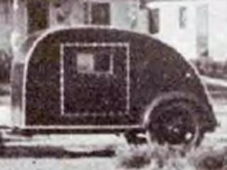

Postby Steve_Cox » Sun Sep 13, 2009 7:59 am
Glad to see interest in the vintage trailers. Why not move the axle back if you are building the Honeymoon. It's not that hard to do. With the door moved forward you loose the ergonomic benefit of not having to scoot toward the foot of the bed to lay down when you get into the trailer. Also it would look like a Honeymoon trailer, not just another teardrop. In my opinion the axle offset is what defines this trailer and the era from which it came.
Steve
Steve_Cox
Posts: 4903
Images: 196
Postby 48Rob » Sun Sep 13, 2009 8:52 am
<img src="http://www.mikenchell.com/VintagePlans/honeymoonhousetrailer.jpg">
I'll second that thought!
While the "kit" trailers may be handy, taking the extra effort to build a frame to match the trailer, instead of building the trailer to match the frame...will make ALL the difference in the final look and feel.
As an added bonus, putting the axle far back where it belongs will give you a trailer that can be pulled at high speeds with wonderful stability.
Take note too, of the wheel size used on the original(s).
Using an 8 or 10 inch cheapo trailer wheel instead of a tire wheel combo that stood at or near 30" high will certainly "take something away" from the look and feel of the design that you fell in love with.
Rob

Postby regis101 » Sun Sep 13, 2009 2:12 pm
Thanks for the kind words. I have to work with what I have for now. In the photo you can see the fender outline just to the left of the door. This is gonna be a bolt on shell.
