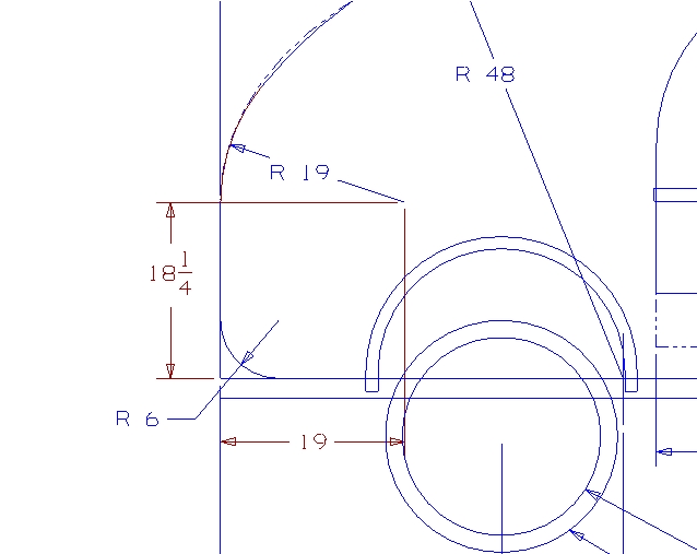

Postby cjm » Sun May 01, 2005 2:32 pm
thanks mike.....a quick question. how do I measure the starting point where the radius changes on the back?....r48 to r19
thanks again!!!!!
cjm :twisted:
cjm
Posts: 26
Joined: Sat Apr 30, 2005 1:28 am
Location: stockton, ca
Postby mikeschn » Sun May 01, 2005 3:02 pm
That 19" radius is a simple fillet radius. The easiest way to do it, if you don't want to try to do that with a compass, is to cut out a 38" diameter disc out of some cardboard, and then fit that disc so that it touches the back edge and the 48" radius. Then trace the disc with a pencil!
P.S. Let me see if there's an easy way to locate the arc center of the 19" radius...
Okay, here ya go... I've located the center for you... see the dimensions in red...
