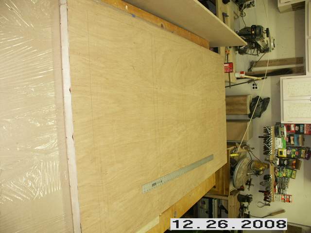

How about no frame at all:
1/4" luan, 1.5" framing lumber, 1/4" luan, blue board insulated, glued with thickened epoxy, fiberglass cloth and epoxy top and bottom.
This floor is flat within 1/16" and very rigid.
