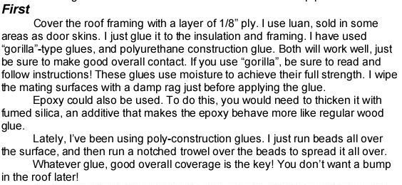

Postby planovet » Wed Sep 16, 2009 5:01 pm
mikeschn wrote:Does anyone remember what Steve Frederick used?
I hope he doesn't mind but here is a short excerpt from his shop notes:
