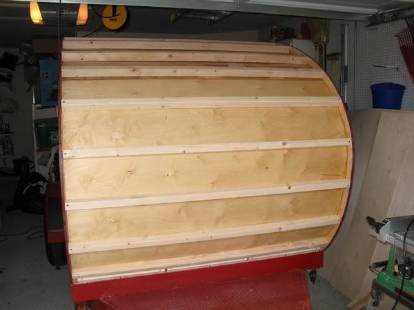

As far as the spars, since you are doing a sandwich wall why don't you screw the spars into the framing and not the walls. If the walls are attached well to the framing, it should work fine. That is what I did on mine. I was able to finish the walls on the bench and not put any additional holes in them after I got them vertical.
Side is up and shows lip where spar will sit;
One spar attached. It was screwed into the framing and not the wall. I used 2x4 for the spars that were ripped down to fit:

BK One wrote:I was going to put the headliner on top of the wall framing per Steve Frederick...
That is what I did. The picture in the post above is a temp spar holding the walls plumb until I could get the ceiling in. It just showed the spar placement better than the pictures with the ceiling already in place.
