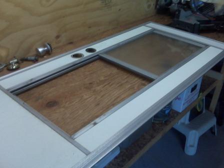

I'd like to get this door apart to put fresh skin and a new window in it... i've taken all the screws out that I can see but I can't get it apart. Is it glued? Do I just pull it apart and try not to bend the framing of it???
Thanks in advance for your tips.
Tam
p.s. this door is to my 1972 Compact Jr.

Yes the skin is usually held on with glue, make that really strong glue! I bent my alum frame when I pulled my skin. Next time I will probably just rebuild the entire door and just use a jig saw to cut the inner diameter out so as not to risk damaging the alum frame. The frames are hard to find and or get shipped.

The glue is most likely older "horse glue" not the new contact adhesive. Try a heat gun in one corner, this may loosen the glue enough to lift the metal.
Another option, try using a long metal scraper like the ones windshield repair people use to get under the window trim and cut the glue with. It looks like a long spatula but very thin with a sharp leading edge.

I would try the methods that Tom mentioned...but to add in the release of the aluminum set the door on its side and try to get mineral spirits between the layers...this stuff will break down most glues and release the grip so it should peel easily :thinking:
The trick is having patience waiting for the mineral spirit to do its job...good luck.

In the early 70's some laminating type construction was done with 2 part adhesives, you might want to try a heat gun on the trim and see if that loosens it.
