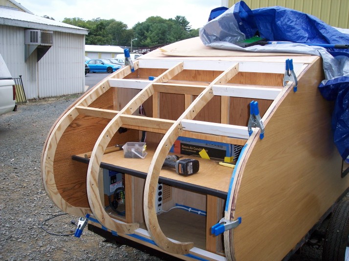

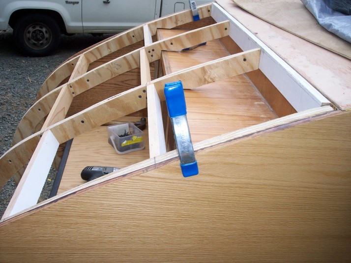

Postby norm's tear drop » Sat Sep 19, 2009 10:22 pm
Im better looking at pictures than reading instructions
but if you need a question answered i'll try to exsplain it
Norm :thumbsup:
I got more pics in my album tab click it to see if it answers any thing in your head
like i said if you have a question just ask
Mine is not finished yet but got her in and need to make some adjustments
thats were the belt sander comes in i have the plastic hurricane hinge but for right now i used 4 flush mount hinges to secure it while i make those adjustment
just ask
