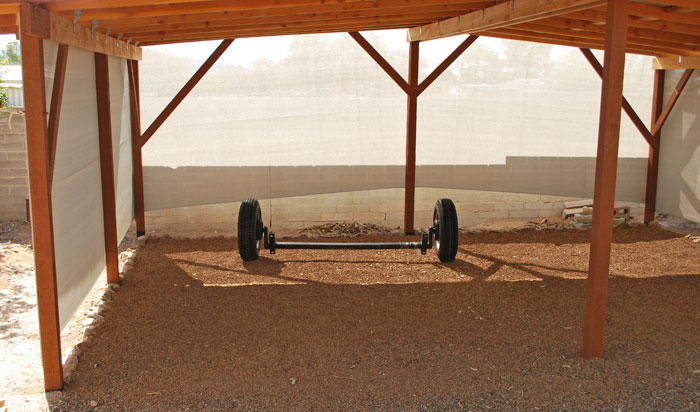

Well, it has started. One unusual little teardrop trailer in the works. :applause:
I have created a website to keep track of my build as I go, and to share everything I am learning with others.

Postby 48Rob » Mon Sep 28, 2009 5:29 pm
Galen,
It is good to see a builder with their priorities in order! :thumbsup:
First the shelter, then the axle.
Great start!

Postby vrodjason » Thu Oct 01, 2009 10:10 am
Cool shelter! Want to travel to Ohio to build me one? :lol: If you dont mind me asking what was the cost of your shelter?
Great job!

Postby Galen » Thu Oct 01, 2009 2:56 pm
vrodjason wrote:If you dont mind me asking what was the cost of your shelter?
Great job!
I spent about $800 on the materials including renting the post hole digger. Wood was really cheap when I built it. And the shade cloth was on super sale. I figure in the future if I want to make it into more of a real shop I could enclose it with hard sides and even lay a cement foundation. But I am pretty happy with how simple it is. I like having the breeze come through when I work. I just won't be working on it during the summer much here in Tucson, except early in the morning.
I looked into buying all kinds of pre-made carports and sheds, but this way was cheaper and fit my space perfeclty. Plus it is bigger.
Galen

Postby starleen2 » Fri Oct 02, 2009 8:16 am
That axel sure looks lonely :(

Postby Galen » Fri Oct 02, 2009 10:15 am
What axel? All I see is a completed teardrop sitting there, just back from a great trip to the Grand Canyon, covered in red desert dust.
But actually right now I am teaching myself to weld so that I can get a frame on top of that axle. I just started to watch the instructional DVD I bought from Northern Tools. Tomorrow I start making my first "puddles". :SG Reports on progress to follow.

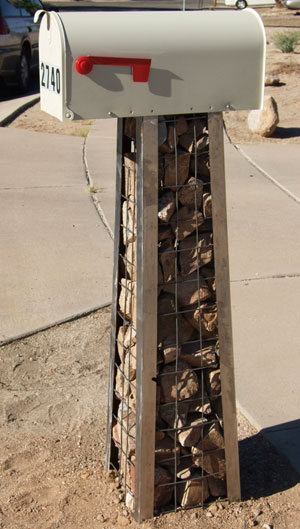

I got bored practicing beads so I gave myself a project to build. I designed a new mailbox post and it turned out great. It is made out of recycled bed frame steel. Using this steel was fine, but it is hardened, and I had to take some of the hardening out of it with heat to drill it.
Galen
