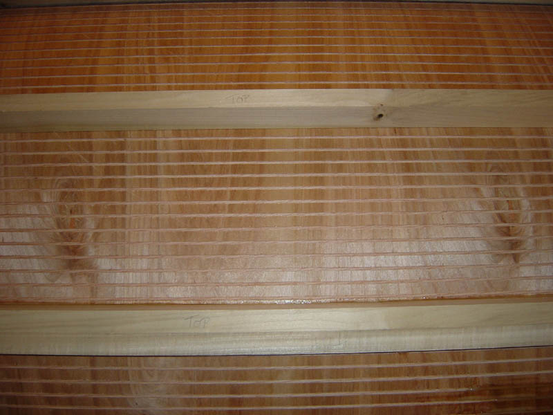

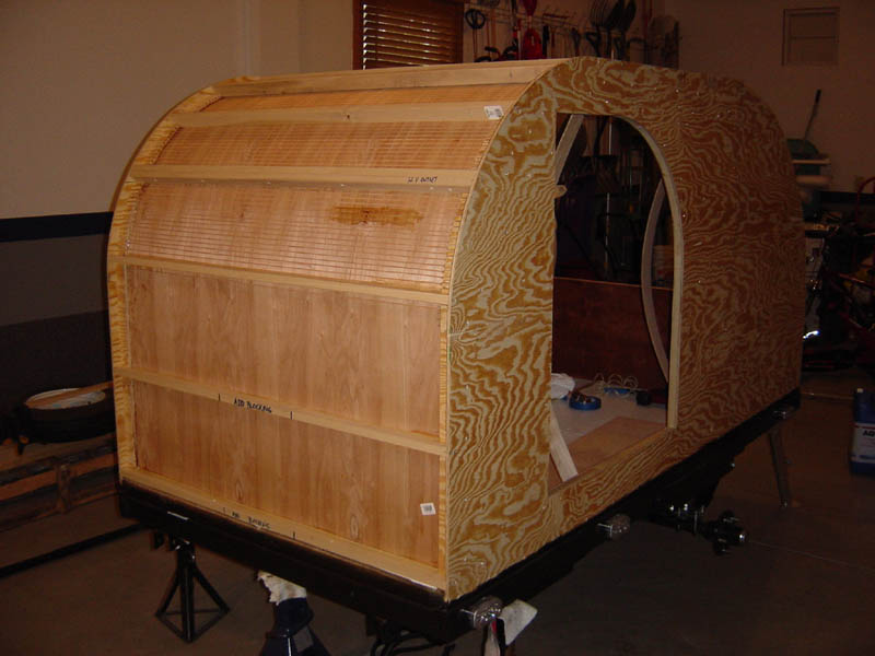

Here is my version of bendable plywood. This is the standard Lowe's stuff (1/8 birch) with lots of kerf cuts! It did take alittle time but it bent around the radius without any problem! I used my circular saw and a straight edge to make the cuts (72!). In the first picture you can also see the temporary plywood supports I used to hold the skin in place while the glue dried.

I did stain, seal and put on 3 coats of poly prior to installing. I kerf cut it to make installation easier. I read in another post that some guys cracked 2-3 sheets prior to getting one to make the radius. I just wanted to make sure it worked on the first try! :)

If the birch plywood was 1/8" how deep were the kerfs cut?

Hey, now that I looked at the photos again, I'm curious about something else:
Is this the exterior roof? Why do I see the spars sitting on top of it?

Postby Ross Wade » Wed May 11, 2005 2:39 pm
IraRat, it looks as though he installed the ceiling panel first. Once the glue is set, he will probably start to lay out the wiring, insulate and then install the outer skin.
It is easier to run all of your wiring and insulate, once the ceiling is in place :twisted: .

I guess it's not really 1/8 the actual measurement is more like 3/16. The kerf cuts are about half the thickness of the plywood. Yes this is the inner skin. After this was installed I placed one layer of 1/2 inch insulation then I ran my wires. Then I installed another layer of 1/2 inch insulation around the wires and a final layer of 1/2 inch over the wires. It sounds like alot of work but it was actually very easy. So I have a total of 1 1/2 inches of insulation in the roof. I will then glue on the exterior skin. You can see more photos here:

Got you. I was confused because at first I was surprised why it was STAINED, but since you're staining the other, visible side, why the heck not do both sides??

Postby Endo » Fri May 13, 2005 5:50 am
IraRat
Only the inside (visible side) is stained. The photo of the outside does look dark but I think the kerf cuts just reveal the lighter colored core.
