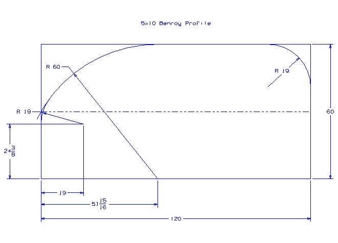

Postby bigmcgiv » Fri May 13, 2005 4:39 pm
does anyone have a detailed 5x10 benroy profile. tks matt :thumbsup:

Re: 5x10 benroy profile
Postby mikeschn » Fri May 13, 2005 4:53 pm
bigmcgiv wrote:does anyone have a detailed 5x10 benroy profile. tks matt :thumbsup:
Yes, that was easy... all I did was take the standard benroy profile, and increase the 48" radius to a 60" radius...
Here's what it looks like...
P.S. It's not possible to go any farther without knowing the details of your build. Are you building on top of a frame, or hiding the frame rails? How thick is your mattress? How thick is your ceiling going to be? Do you need a 30" wide door or a 32" wide door? Are you going to have an inside closet in the front of the teardrop? How big a window do you want?
But there's the profile you asked for! ;)
