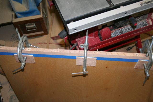

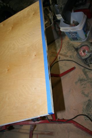

When you cut the door cut out take the scrap, soon to be door and do the following.
First rip 3/4 of an inch off one side, starting with the bottom side is best. Then tape right next to the cut.

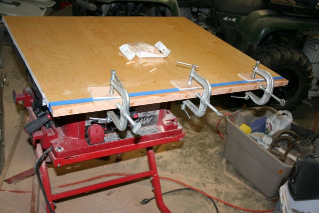

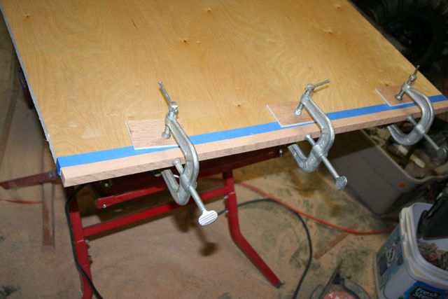

Then rip a piece of one by oak to 3/4". Clamp the cut side to the door.

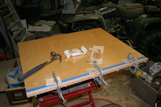

Drill a buch of 1/4" holes in the end about 6" apart.
Unclamp it and smear glue on the door edge (use 5 min epoxy for those times you can't wait, you know what I mean). Then reclamp while pushing dowls in to allign.
Hammer the dowls home clean off excess glue and have good side of door up.
Work your way around the door doing the top last. The reason for doing this in order is so you won't have end grain where water can stand on it.

A couple of other points, those clamps are ok but large bar or pipe clamps would work just as well or better. The 3 way clamps can pull when you tighten the last screw.
The use of dowels makes planning the door during fitting easier. You could use countersunk screws also.
The good side of the wood is up so that when gravity causes some glue to weep out while it cures it will not be on the good side of the wood.
