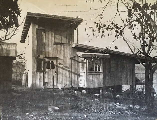

I realize that this is an OLD thread, but I had to comment on the VW windows. I built my first house from scratch, boards from the sawmill, paycheck to paycheck. I also built both of the doors. The kitchen door had two VW windows. It was SO cool.
I lived in the Missouri Ozarks and you could build anything you wanted. Here is a pic of the house before it was complete.
(Circa 1978)
