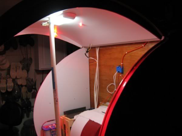

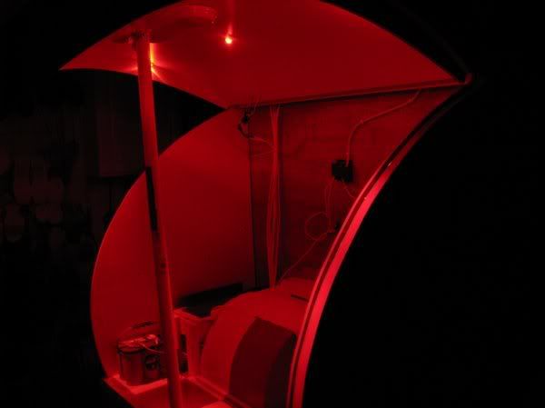

I use a single fluorescent light in my galley and it provides more than enough light for my taste. When I'm camping I don't like a lot of harsh light anyway. The light has 2 small fluorescent tubes in it. I also have some red LED lights on the hatch for mood lighting. Sometimes it's all I need to grab something quick and it won't ruin my night vision.
Here is a LINK to a similar light on eBay. I have no affiliation with the seller.
The first picture is in a dark garage with the fluorescent light on. The second pic is with the LEDs on.

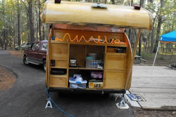

We have a florescent light at the top of the counter and one on the top shelf. There is a stick on puck light for low light needs. I also use an orange rope light for night. Lots of light and no bugs. If I were going to make something complicated in that galley I would want more light.
The other nice thing about the rope light is it doesn't blind you if you are walking up to it. Nice way to find the TD in the dark...........

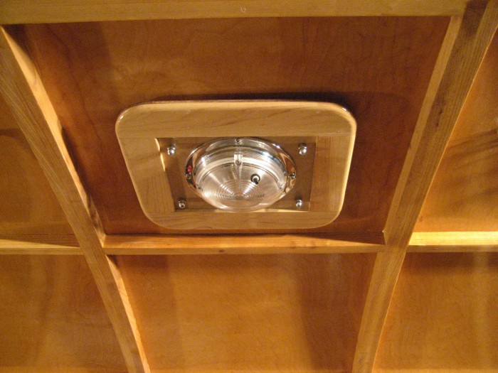

Postby Mightydog » Thu Jan 21, 2010 9:08 am
We have two dome lights that look like this one:
