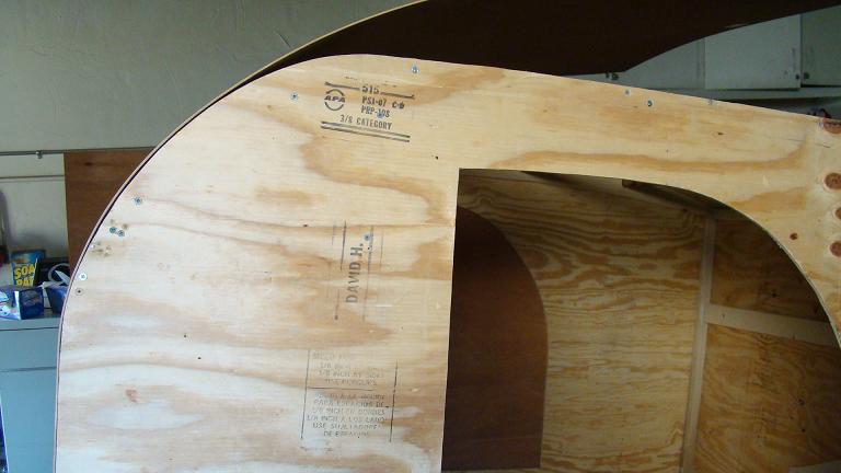

Thanks for the response guys the wood is 2.7 mm thick atleast thats what it says.
here is the link to the pictures of what i got going on.

It appears in your photograph that the grain is running the long direction of the sheet. I think if you were to turn the sheet 90 degrees from the way you are trying to install it, it will bend easier. If you do turn the panel, make sure your joints fall on flat surfaces and at a distance far enough from the radius that the is no ongoing stress in the joint(s). You may still need to use moisture or steam to achieve this radius.

It sounds like your trying to bend it too much without something backing up the outside. I'm not sure if I can explain this right but, from your pictures you are doing two things wrong for bending plywood with the grain in that direction.
1.. Your nails are few and far between, on the curve (and just before and after) you need to nail every couple of inches, not every 8".
2.. No straps, get a couple or a few straps that can be tightened as you nail. this will support the outside of the ply. You see, you have the sides supporting the inside while it bends, but nothing from keeping it from kicking out so it's going to break.
Once you do this, leave it for a few days to take the shape.
