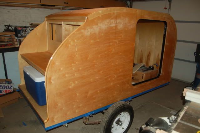

Postby Mauleskinner » Wed Feb 24, 2010 5:22 pm
I used basically a butt joint...built the walls, and laid in the roof over them. Stuck wood-to-wood with thickened epoxy for that part. You can see in this pic how I left a little overlap that I trimmed off...
Rounded over the corners and laid a strip of fiberglass tape along all the joints for extra strength...

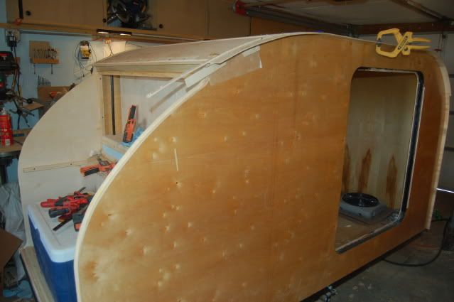

Postby Micro469 » Thu Feb 25, 2010 9:59 pm
Reddiver wrote:OK the roof is on the roof and sides epoxied . What I am talking about is the 1 to 1 1/2 trim around the perimeter of the roof line on the sides , that make it look like a Woodie. So when joining the trim pieces are they butt joined on the 1 1/2 side or lap joined , doweled, biscuit, lap . What kind of joint between trim pieces. Damn I talk better with a pencil wish I could do that.
Here's how I did it. Hope it answers your question. The trim on the sides were shaped to follow the side profile. I sanded the top edge flush with the roof line. They were epoxied and screwed to the sides, and when dry, i removed the screws and filled the holes with dowels, and sanded flush. On the roof edge, I cut 1/8 strips out of 1x2's for the full length of the roof. I then epoxied three of them together along the edge, clamping every few inches. (Much easier bending 3 1/8 strips around a curve than a piece of 3/8 lumber). When dry, I removed the clamps and sanded the outside edge flush with the trim on the sides. No screws were used on the top trim, and it hides-seals the roof to side butt joint.
