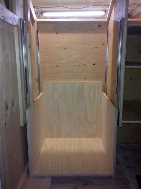

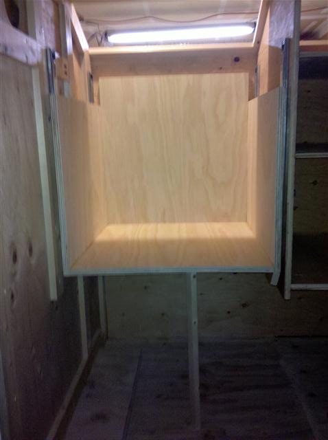

In my design I needed to have a spot for a porta potty in my teardrop. So I figured on a drop down area in the interior cabinet.
This is a picture of it in the up position.
This is a picture of it in the down position.

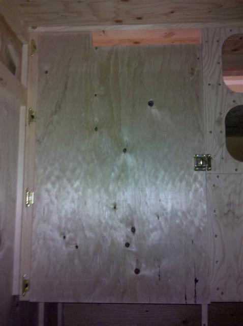

Here is a picture of the door closed.
I went back and forth on the lift mechanism, linear motor or pulley's and cable.
Cable won out only due to the fact it will have no drain on electrical systems and it will still work if the kids crank the stereo all day.

I imagine that the wife and anyone else will want to have the cabin doors shut whilst using it. But, I plan to hang a small curtain around it when parked to allow for accidental door opening protection.
The drop down is obviously over a sleepers feet so there will be two lock off pins that go in whilst traveling and sleeping.
It is a two person cabin, any others will be tent camping. I originally designed it with a bunk for a third person, but decided I wanted a 17" touchscreen and computer instead :thumbsup:

Postby Miriam C. » Wed Mar 03, 2010 9:27 pm
:thinking: Well I have had more time to think about this and :? So um you have the thickness of the mattress and even at 4" you only have about 3 1/2 feet tall at the most. Then you need to take off for the height of the porta potty. It is going to be very close. If you have kids and they are in a tent you might wall off space for the porta potty.

Postby MceeD » Wed Mar 03, 2010 11:09 pm
All great thoughts,
First off yeah it's a bit cramped. :shock:
I don't believe my teardrop is normal size. I just looked around alot then drew one up for my needs and ideas.
My first drawings were with a 5' ceiling in the cabin, which would have been perfect. But due to a small problem with getting it out the darn garage door height, it is now 4'6".
I'm using a 1/2" foam pad with a 4" memory foam mattress. I'm going with a guess it will compress to about 1". I have no plans for rolling up the mattress. that portion is at the feet and it being foam should fair well and return to form pretty well.
The portta potty I plan on using is 16" tall. I will have to lean my head forward some while sitting. Luckily, I don't plan on doing any reading in there.
The plan is not for a constant use, more of a middle of the night (wife) or for convenience/emergency. :worship:
Oasis Maker, it is not rude at all, nothing like expressing your opinion with the force necessary to convey your conviction. You actually made me chuckle :thumbsup:
I'm certainly understanding it will be a pain for middle of the night use and if smell is a issue I hope it curtails the use a bit.
I do have a secondary plan to have a sealed lid over the potty in this event tho, and with the sound of your conviction I may just put it on now. :D
