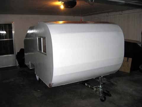

Postby starleen2 » Sun Mar 07, 2010 5:17 pm
OK folks - either I did something wrong or you guys are just analysing way too much. Here are some construction picts of the ladybug. What you are looking at is 5mm luan with fiberglass tape only on the seams and then then entire body sealed with polyester resin rolled on in two coats
The outside front curve was done in strips because it has a compound bow in it
Then to radius the corners and smooth the transition, body filler is applied and shaped
Finally painted in ENAMEL exterior latex house paint - and it has held up in the Texas summer heat, been in freezing rain - and everything in between. Nothing has delaminated or separated - did not use CPES. I'm sure both of you have many years of fiberglass experience - way more than me ( slim to none) and you can probably give us numerous reason why this will not work - but there she is - explain the anomaly? ;)

Postby glassice » Sun Mar 07, 2010 5:56 pm
starleen2 looks great .That why I ask what the wood look like to show the wood just epoxy is the best. To hide and cover you can not beat the way you did it . That why I said I DONT THINK YOU WANT TO FIBERGLASS YOUR TEAR . If you get a litte time try rust-oleum it has a harder coat than laytex you coated the wood with res. Fiberglass is using some tipe of fiber with a res. With a glass trailer and NO plywood under it less time to upkeep easer to fix . Not roting from the in side FOR US I my shelf that will not look for leaks
