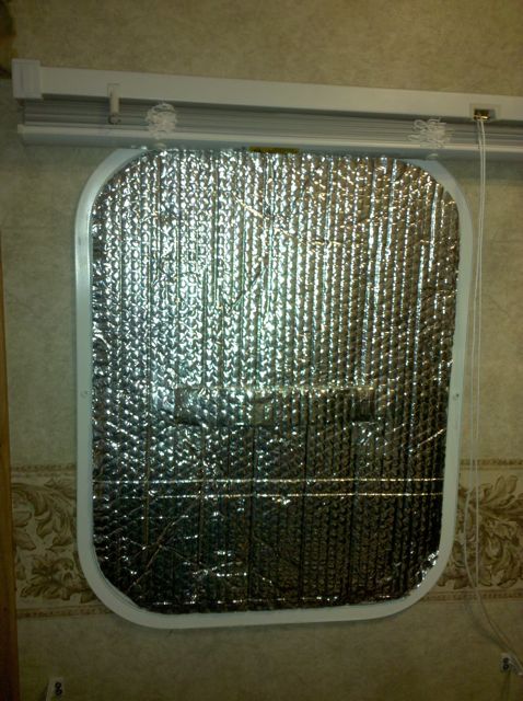

here's a simple solution for a second "pane" made of reflectix.
bubblewrap without the foil would let light in.
