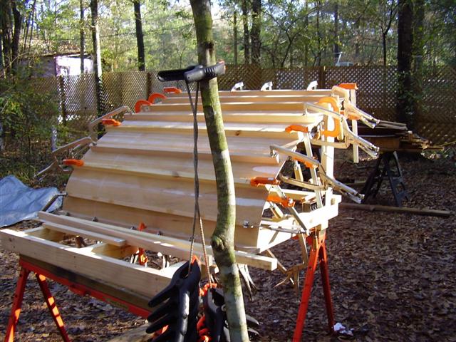

Here I used about 30 clamps and 10 cauls to glue the plywood skin on the hatch frame. Notice the spring clamps hanging on the tree in the foreground. They were not suitable for this application.
For pipe clamps, I made up four at five feet but only actually ever used three of them. I have several shorter pipe clamps, and some of them were used during the build.
I also used concrete blocks, power tools, tool boxes, fire wood, and even a 110 pound anvil when the need for "gravity clamps" came up.
A Kreg jig can eliminate the need for some of the clamping but you will still find that, like everybody already said, you cannot really ever have too many clamps.
