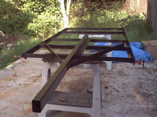

Since I don't have a pic of my frame yet (it's not finished), I'll use one that Jerome (dguff) just posted on another thread
I really like the diagonal braces for the tounge, they strengthen the tongue as well as remove a lot of the flex from the frame because they attach to the crossmembers. I usually bring mine all the way out to the side rails. They are also a nice place to mount your side marker lights, and keep them out of the way. I think you can get away with a thinner walled tounge if you use braces.
