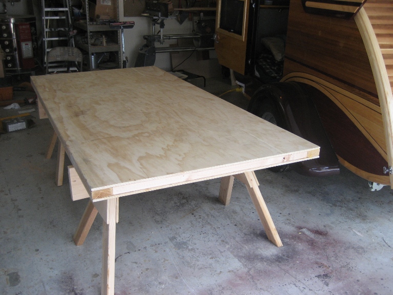

One of the problems in not having a nice heated workshop is that you never have a good work surface that is big enough for panels. On my first build I always had something cobbled together. This time around, I have made up sawhorses and a full work surface that I can set up inside or out to work on. I think it will be worth the extra cost and effort as I get into the build.

Postby bobhenry » Mon Mar 08, 2010 12:12 pm
gregp136 wrote:It always bothers me when peoples work benches look nicer than my final product....
:lol:
Seriously, I like that idea. I have the horses but tend to use one side on top of the other to support them.
Greg (and Laurie)
We discussed this elswhere but it fit here too !
