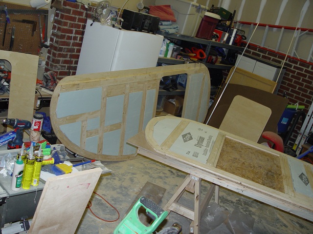

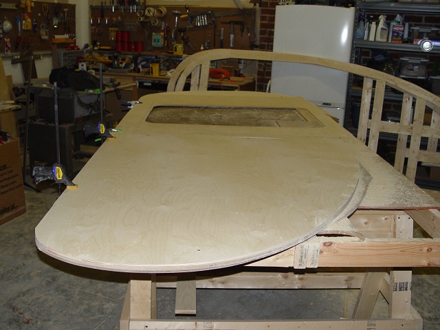

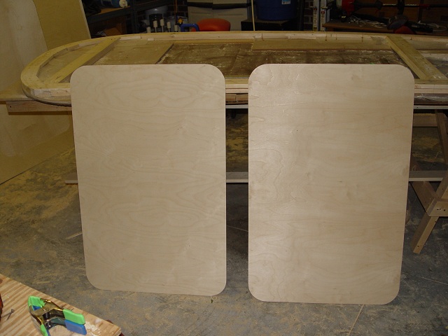

I am getting excited - I am meeting with the welder to start the trailer build this week and the aluminum comes in on the 20th! WooHoo! I have attached a few pics of the progress so far. Thanks again to everyone.

:applause: :thumbsup: Nice doors and stuff 8) butyl tape from an RV store. Wasn't too expensive. Be sure it isn't dried out!
