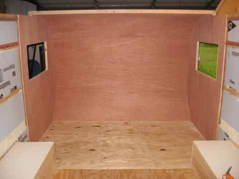

I tried spraying a large area and the over spray was horrendous - But I didn't have a HVLP gun either - used three quarts for what you see. I could have used just one if I had not sprayed it.
to this
