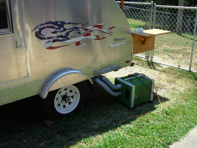

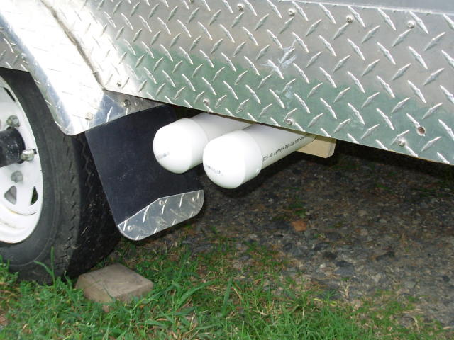

prohandyman wrote:I have looked thru all the threads, and have not found what I am looking for. My current build for a young lady is to have connections for a Pet cool unit. We don't even have the unit yet, so I am going on the info I have seen on the forum to install it. Below is my connection/installation so far. The 2 - 2" pvc pipes are tucked in behind an access door, where the pipes run thru the bottom of the forward cabinets. Am I right about the 2" connections? It is not too late to change it if needed.
60mmOD/2"ID ?? - the dimensions are close enough that the connection hoses that come with the pet cool fit tightly & work great Dan. Here's pix of my installation (not as neat as yours but it works for me) using the 2" Schedule 40 PFC ( I use the slip on 'endcaps' as dust covers instead of an access door). I think the hoses should be long enough to reach your connections while the PC is setting on the ground but if not, shouldn't be a great chore to make a base that'll raise it a few inches.
