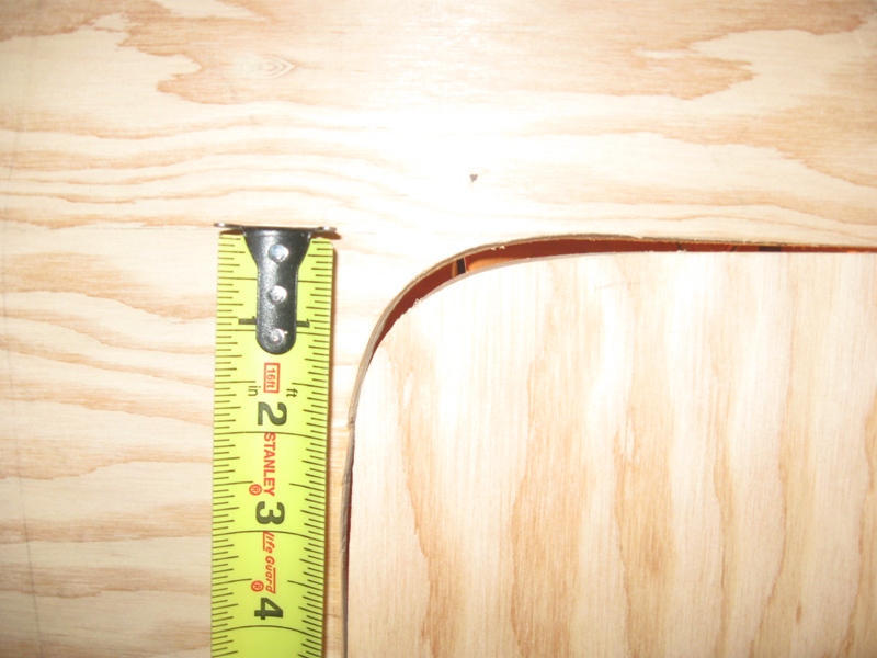

So just like my barber, I took a little too much off, and I'm wondering if T-mold will cover this particular mistake up. It's about 1/4" at its worst. Thoughts?

It should cover it. You might take a piece of the 'T' molding and check to be sure. If not, just cut another door using the opening as your guide. Also, you need at least a 1/4 inch gap on three sides. The hinge will control the gap on the hinge side. You need the gap for the 'T' molding and door closure clearance.
P.S. A trick that a few of us do is use the plug that you cut out of the side for the door opening as the door. That way, most of the time it will line right up with matching trim, male/female.

I'm not so sure that you are in any trouble. It looks like you don't have enough gap on the rest of the door. Get yourself an old fashion compass with a pencil attached, and scribe out a 1/4" line all around the door. You might be surprised.

Thanks for putting me at ease, I've heard many refer to a 1/8" gap for doors so I thought I was in trouble, but taking more wood off has never been a problem for me!

a 1/8" gap is more for furniture and cabinets than passage doors. 3/16" to 1/4" is the norm for most passage doors. if they're solid wood doors, frame and panel or slab, a 1/4" is about the minimum because solid wood expands quite a bit and it's all in one direction because of the hinge.. when I install doors I always make at least 1/4" to allow for expansion and hinge slop. nobody notices a gap unless it uneven but everyone notices a door that rubs and binds in the jamb.
