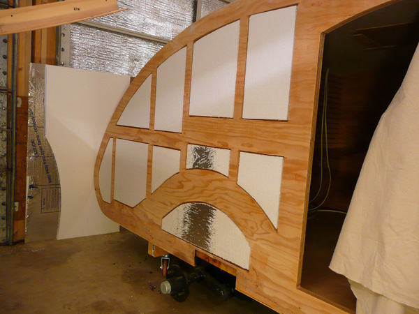

As you stated, this issue comes into play if you want a teardrop that "sits" lower than most. I wanted the same look, and partly as a result I had to "notch" my sidewalls to allow clearance for the torsion arm.
Actually, my torsion arm cleared the sidewall by about 1/4", but I wanted a little more clearance. The trouble comes in fitting stock wheels to the fenders and axle you selected.

I did like what Chris said, I picked and measured my wheel, fender, and how the teardrop was going to sit on the frame before I ordered my axle. Like Tom, My teardrop side hides the frame so I had to get some extra clearance for that too. I ordered a dexter axle from AAWheel in Kansas found them on the internet. I did pick the short spindle option and it gave me another inch (half inch per side that is) to clear the side of the tear without adding another inch to the total width of the axle.
