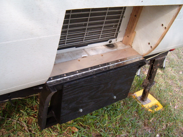

This is how I vented mine, the center has a ramp that vents the exhaust air out the top. The sides draw air in from the back, there is a vent under the ramp. I've used this setup for 4 straight days in 100+ weather without it overheating or freezing up.

Postby caseydog » Mon May 24, 2010 11:00 am
As already stated in other words, you need to...
1. Provide a way for fresh outside air to get to the vents on the side of your AC unit (intake air for the condenser coils)
2. Provide a pathway for hot air coming off the back of the unit to get out of the camper.
I simply put vents in my galley to let fresh air in, and build a box on the back of my unit that channels hot exhaust air to a marine vent on the side of my TD.
If you look at the photo below, you can see the the box for the back of the AC unit. On the side of the TD, you can see a tall vent with louvers, which allows fresh air into the galley area where the AC unit is. Behind that, you see a rounded vent that covers a four inch hole where exhaust air leaves the galley.
Both vents have bug screens to keep the critters out.

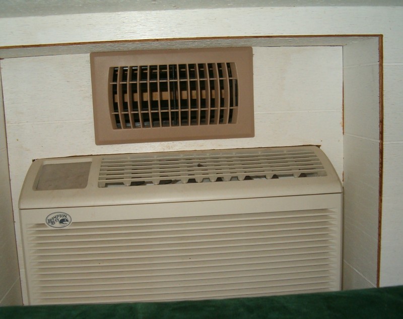

In my installation air is drawn up through the floor for intake air and the exhaust is blown directly out the back of the TD. I have an additional vent to the intake air box, both to allow cabin air to mix with the intake air and as an intake when using the Fantastic Vent for circulation. When there is no shore power for the Air Cond, that little vent at the foot of the bed allows fresh cool air from under the TD to be drawn in rather than only having the widows/doors for air flow.
I allowed for intake air on both sides of the A/C unit because someone suggested that I should allow the same square area (square inches) for intake as the existing louvers on the case allowed. Not sure if this is essential but it cools the cabin down quickly, dehumidifies well, does not short cycle and does not overheat. The exhaust air exits unrestricted out the back is totally isolated from the intake on the sides.
