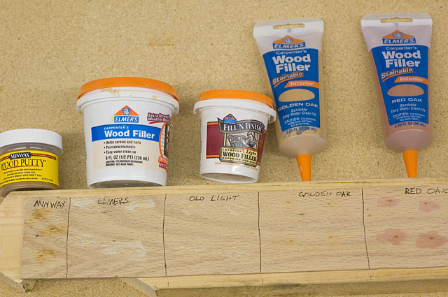

I have red oak paneling and used Minwax Golden Oak stain. For filler in the brad holes I used the Elmers Golden Oak stainable filler. It worked well for me. Here is a photo of several brands I tested before deciding on which to uese.
Note, the Minwax brand on the left is intended to be used after the workpiece is stained and finished, all of the others are pre-stain types. Good luck with your project, I hope it comes together in time for Minden.

Postby Michael W » Sat Jun 11, 2005 8:47 am
Here are the photos of the wood filler test board on the red oak panelling. The second photo shows the results after it was stined wiht Minwax Golden Oak Stain and Minwax Satin Spar Urethane. You can see why I chose the Golden Oak colored filler. It hides the brad holes the best.
