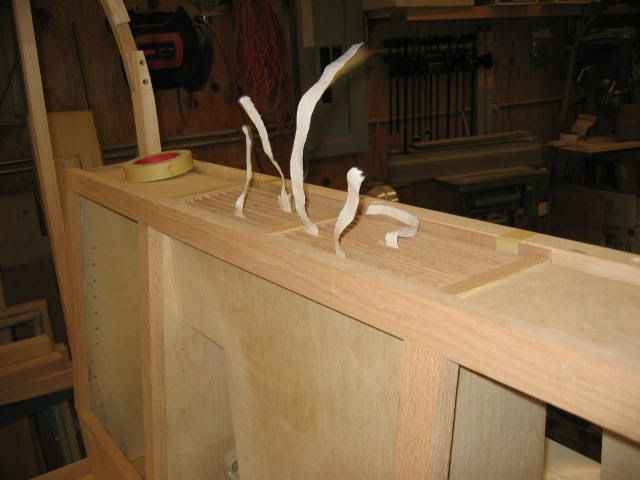

I have my AC exhaust into my tongue box. I just prop the lid up and rest it on the latches. So the opening is about 2" X 40". The grill in the picture is the AC inlet. There is a wooden deflector sending the cold AC straight up out another vent in the top of the headboard, So no cold air blows on me. I find that cracking the ceiling vent gives be make up air. Works real well.
here was a test during my build, The paper streamers show the cold air blowing out the headboard vent.
