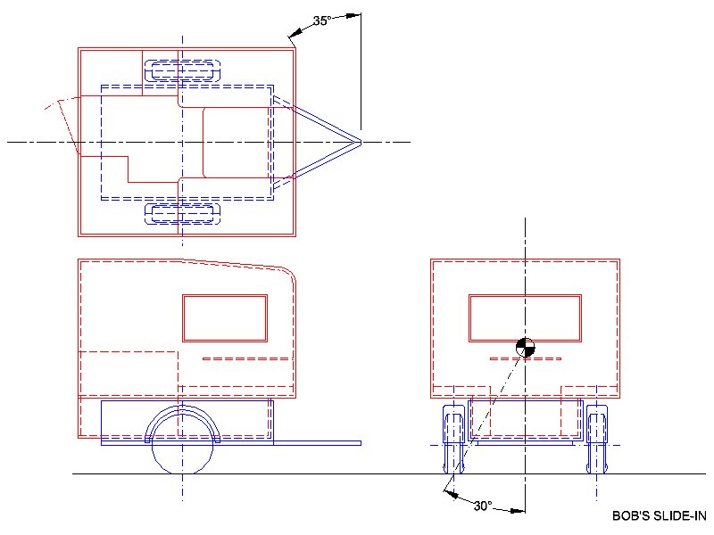

We have also had several discussions about building bodies to slide onto utility trailers - but I can't for the life of me find any of them! For one of them I did this design to fit on a 6 x 4ft utility trailer - musta been owned by a 'Bob' from the look of it:
But the question about this type of design is how high it becomes and so whether it is stable - the design shown here assumes a fairly low-riding utility trailer - a normal HF trailer has a deck somewhat higher. Stability to a 30 degree angle is quite good enough (0.55g lateral acceleration) for cornering, but whether it's good enough for a typical accident-avoidance swerve, I don't know.
Incidentally the pick-up camper gets round this by being a (relatively!) light camper on a heavy truck, so it's the height of the truck's center of gravity that matters most.
