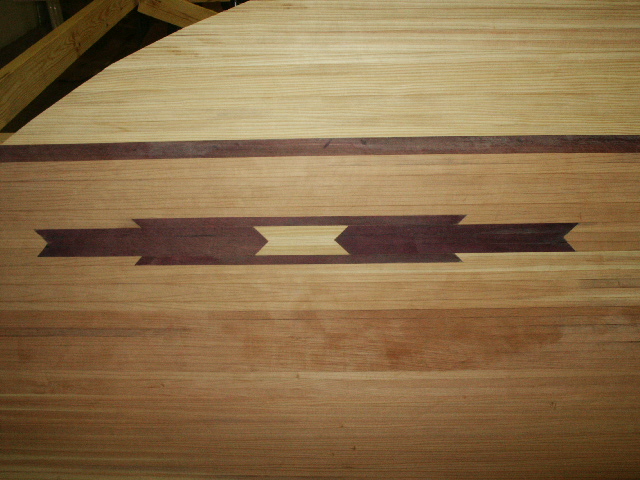

I used it as an accent on The Paskett Case:
The other woods are African mahogany, maple, and birch.
As Doug said, it will turn brown with time. You can slow it, but I don't know of any way to stop it. Of course, that's true for pretty much any colorful wood. Just enjoy it, you're getting older, too!
