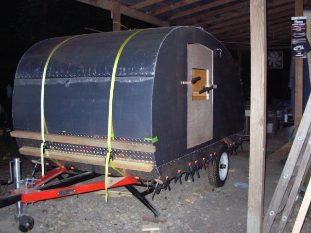

I trimmed my TD with .062" diamond tread. Not sure if it's because of the 'diamonds' but it was lots heavier than the .040" mill finish that I used as skin. I'm pretty sure that I wouldn't want to use even the .062" for skin. Another thing, it seemed on the stuff I used that the base thickness was .062" with the 'diamonds' standing 'proud' of that thickness?? Anyway it was lots harder 'forming' the diamond tread for the front trim than .040" would've been. The .062" is 'heavy' enough that I formed my tongue box from it & it's very sturdy.

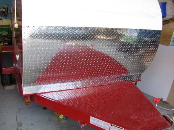

I used .063 standard diamond plate and it worked fine. It should be just right for what you want to use it for.

If ya don't hafta 'form' it, & weight doesn't matter a lot, i.e. your tow vehicle has sufficient weight/power, it'd probably work well for what you describe. Should definitely give additional rigidity in off road stress/torque situations, depending on how you fasten it. If the price is right, I'd give it a shot :thumbsup:
