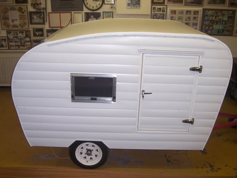

Postby len19070 » Tue Jun 22, 2010 7:31 pm
Yep, I use it all the time.
It has to be used with the creases in it though. If not...if laid flat it'll get all wavy.
http://serroscottycamperenthusiasts.com ... gfinal.pdf

Postby len19070 » Wed Jun 23, 2010 5:53 am
Anything will ding if ya hit it. :lol:
I've done about 6 entire trailers with it and a lot of repair pieces over the past 4-5 years
Really haven't had any problems with it.
Not really sure of the thickness, its just every day run of the mill Brake metal that's used for capping windows & trim.
2'X50' roll, about $80 at Home Depot.
Happy Trails
Len

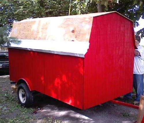

Postby bobhenry » Wed Jun 23, 2010 6:07 am
Used it over 3/8 ply for the roof on "The Barn"
I started at the bottom and worked up just like shingles.
Postby len19070 » Wed Jun 23, 2010 10:38 am
Just one item I'd like to add on my using Brake Metal for siding.
We're in the middle of our second heat wave of the season.
In the middle of the day, the siding does start "crackling" and expanding a bit...you can see the "rolls" on the siding getting a bit more pronounced.
But only in excessive heat & sun light.
As soon as the temp goes down everything goes back to normal.
But then under the same conditions I have heard and seen Manufactured Trailers with Aluminum siding do the same.
When your out on an RV lot in the heat with 60 or 70 trailers all around it sounds like a building getting ready to fall over.
