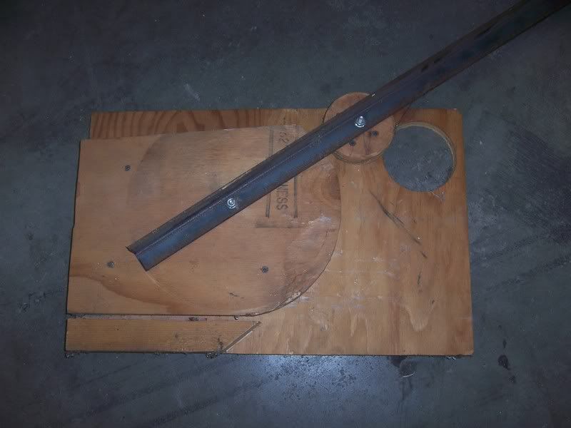

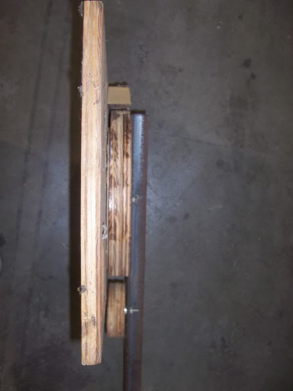

Postby len19070 » Fri Jun 25, 2010 4:27 pm
I built this gadget a few years back for bending Alum Angle.
Though the photos show a piece of RV molding, it works well on a Home Depot style 3/4X1/2" angle.
There is a slot shown in the 3ed & 4th photo that is the thickness of the side leg.
While bending, the side leg has no room to go side to side and will only go straight with no ripples.
Bending must be done S-L-O-W-L-Y
On large radius's
I just bend slightly and slide the molding forward a bit then bend, then slide, bend, slide etc.
Doing a bit of Over bending is good.
Happy Trails
Len

Postby starleen2 » Fri Jun 25, 2010 4:32 pm
HUMMMM :thinking: - I think I know what's gonna be the next tool I build!

Postby glassice » Fri Jun 25, 2010 4:48 pm
Len your the man I try to up load pic from my lotus7 book that show that set up but your pic are much better

Postby Toytaco2 » Fri Jun 25, 2010 6:03 pm
I can personally attest to Len's bending gadget. I made one using his pics to bend the insert molding for my TD. It worked great, especially for the wider legged molding I used on my hatch.
An otherwise difficult job made very, very easy. :thumbsup: :thumbsup:
