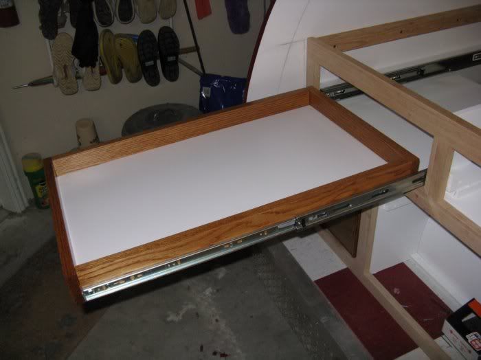

Hey folks, Ive just sanded down the platform from Birch Ply. And want to make a tray or table that is pulled out from under the counter in the galley. This would hold our stove.
Have you folks built such? If so can I kindly ask for some pics of yours?
Should would appreciate it.
Are there sides on it? A front plate maybe?

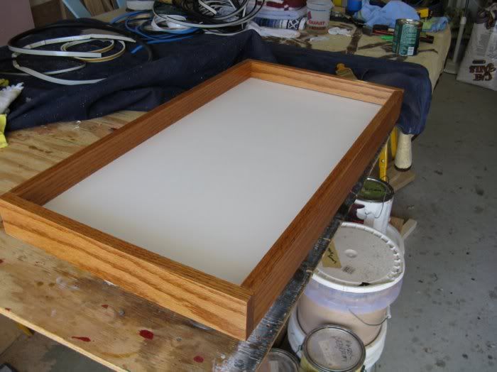

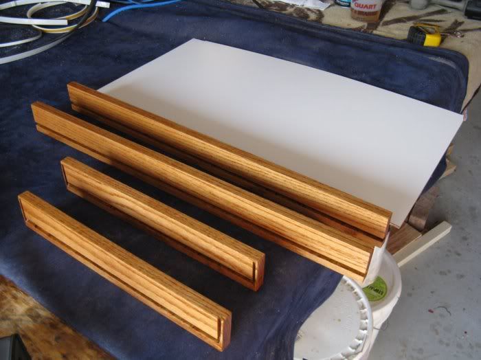

Here is how I did mine. I made a base out of 1/8" ply and covered it with some leftover white Formica. I made the sides out of 1x2 red oak. I routed a groove in the sides for the base to slide into. I used biscuits and glue to hold it together. I then mounted it on full extension slides. I screwed a drawer front onto it and put on a handle. I think it works very well and it's hidden out of the way when not in use.

Wow now that is swweeeeeet as candy. Great looking too, such is your entire tear.. :applause: :applause: Thats about what I had in mind.
Ive got 1/4 inch ply (aprox) is that too heavy do you think?
The only thing we dont have the depth so we,ll have to do with it being length wise under that galley top. :cry:
Mark how long are the extension rails that you have?
Thank You Mark for taking the time to reply to this. :thumbsup: :thumbsup:
