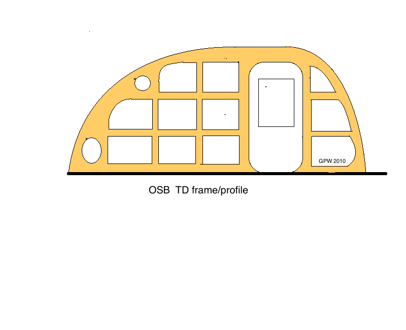

Just an idea... I t might be possible to use OSB as the TD frame /sides.. by cutting out the profiles , then cutting out the inner areas for doors , windows , etc, AND cutting out the heavy inner areas to make a "frame" ...then some Aluminum (whatever) screwed on the outside ... ??? OSB is HEAVY!!! :o

Here's just an idea for an alternative material frame/profile ... lightened.. Could be even CNC cut ...??? :thinking:

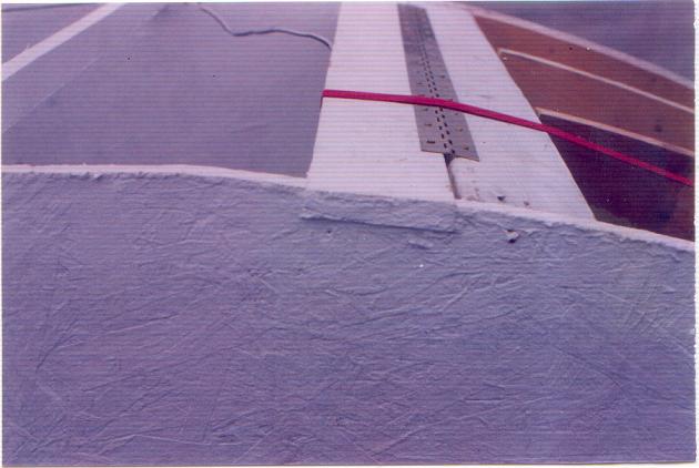

You say 'Long Haul'? I'll only post a picture and then you decide. Oh, and this is a California trailer. :thinking:
