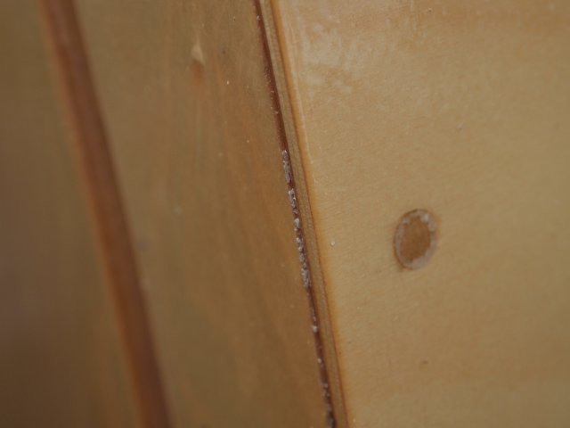

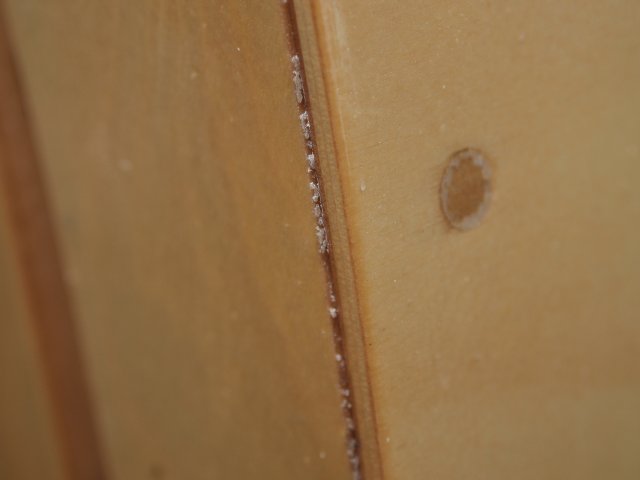

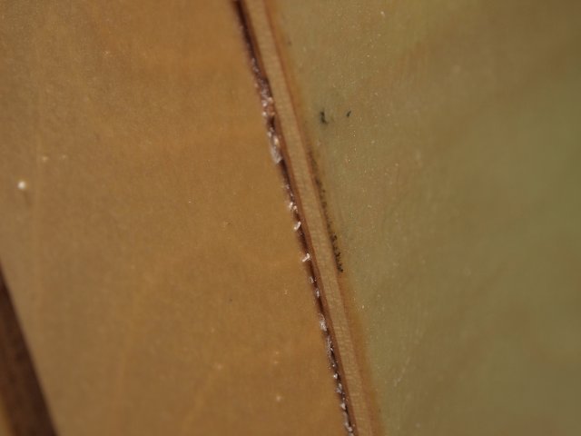

On my hatch, I have 1/8 inch baltic birch with 6.5 oz fiberglass cloth (right side of pictures), after sanding the sides smooth and epoxying it with several coats of epoxy and glueing it down with tightbond 3 it looks like it has shrunk and separated on the edges. Is this to be expected and needs to be covered with trim? or do I have other options?

:o Your pictures are wonderful but so close up I can't tell what I am looking at. Any chance of getting a bit further away?

Postby Alan and Lianna » Thu Jul 15, 2010 1:52 am
No, it was glued first. It appears as though the 5 foot birch ply shrunk approx 1/8th inch after being glued and epoxied and 3 weeks in the sun.

Postby afreegreek » Thu Jul 15, 2010 2:12 am
Alan and Lianna wrote:No, it was glued first. It appears as though the 5 foot birch ply shrunk approx 1/8th inch after being glued and epoxied and 3 weeks in the sun.
Alan
I suspect you took too long to assemble the parts and the glue didn't bond well.. it's almost impossible for a glue line to give out like that.. you should have had fibre separation as a good glue bond is stronger than most woods that are not resiny or or oily (rosewood/teak etc)..
if the panel is otherwise sound, an easy fix is to rebate the edge and glue in a corner piece.. say 1/4 x 1/4.. if you do a clean job with the router, it will look perfect..

Postby Larry C » Thu Jul 15, 2010 7:48 am
Alan and Lianna wrote:On my hatch, I have 1/8 inch baltic birch with 6.5 oz fiberglass cloth (right side of pictures), after sanding the sides smooth and epoxying it with several coats of epoxy and glueing it down with tightbond 3 it looks like it has shrunk and separated on the edges. Is this to be expected and needs to be covered with trim? or do I have other options?
Alan and Lianna
You could, after filling the gap, cover the entire edge with 2-3" wide bias cut strips of fiberglass. Something in the 3-4oz. range would bend over the corner easily, especially if you break the edge a little.
If you left the unprotected fiberglass/epoxy exposed to UV from the sun, you may have more problems down the road, especially if your leaving the wood bright. The sun actually may have shrunk the fiberglass and that's what pulled the edge. Can you see glass print thru? This is an indication of shrinkage.
One more thought is the Titebond 3. At what temp does it soften? Titebond 2 softens in the sun and any glue bond under tension can be a problem even under fiberglass. This can be a problem on the decks of strip built kayaks when using dark wood strips.

Postby michaelwpayton » Thu Jul 15, 2010 6:53 pm
Larry C wrote: ... If you left the unprotected fiberglass/epoxy exposed to UV from the sun, you may have more problems down the road, especially if your leaving the wood bright.
Epoxy MUST be UV protected.

Postby glassice » Thu Jul 15, 2010 8:43 pm
It's look like the glass did not pop you might have something expanding in side is there some wood on the inside that got bigger in the heat if so cut a re leaf at the end and re glue
