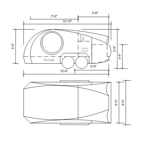

Postby TD Beej » Fri Jul 30, 2010 11:53 am
BigAl wrote:I agree that a small RV trailer lends itself well to the technique, but most boats are built with this technique around frames that define the shape whilst the glue cures. These frames are either temporary (like a form) or are part of the boat (like a transom or seat fames, etc,).
How do you hope to keep your shape true whilst the glue cures?
Can you share with us a sketch of your shape?
Check out this excellent SnG boat building Tutorial
For the shape I am planning to use prestressed panels, two sheets of 1/8th w/ or w/o insulation curved to the correct shape and then fiberglass and epoxied together.
This is still my target though I keep tweaking things and probably will do so right up to and during the build.

Postby BigAl » Fri Jul 30, 2010 12:21 pm
Lookin groovy Beej!
Couldn't you just build it with glass over sculpted PE foamboard, and forget the ply on the outside?
You could embed ply panels in the foam where you need a mounting for a hinge or a light.
