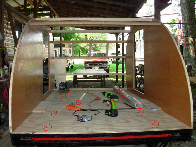

I did the same - Since I carry a motorcycle in the trailer I welded the frame after bolting it all together and then I used 3/4 inch ply and eleven 3/8ths carriage bolts . . . . 4 down each side and 3 in the middle. The heavy ply and the welding really stiffened up the 'wet noodle' HF frame!!
For a teardrop, 1/2 inch ply and 1/4 inch carriage bolts should be sufficient - 3 down each side and then 3 in the middle. Your back will never feel the 1/4 inch domed bolt heads ;)

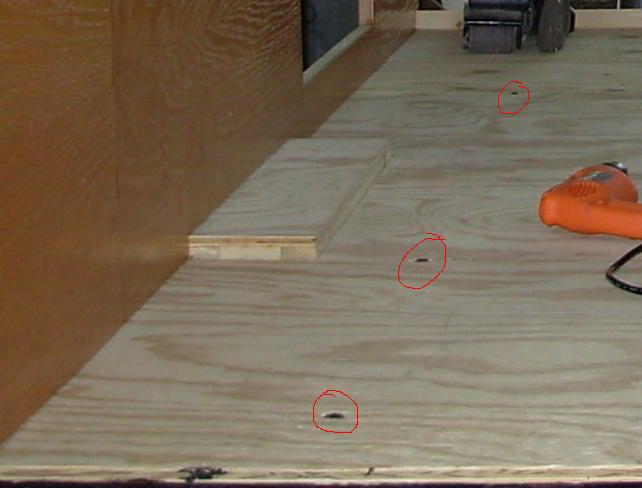

My floor is built with 1 1/2" frame (ripped 2x4's) & 1/2" plywood with 1" Dow foamboard underneath. I used ten (10) 3/8" carriage bolts of sufficient length (3"?) to reach thru the upper side of the frame 'C' channel. Drilled thru the floor & frame cross members with 3/8" bit & when placing the carriage bolts, drove the square 'shank' (underneath the head) into the plywood. That'll hold the bolt 'til it's tightened.

Better late than never. I am on my 2nd build and I just bolted the floor to the frame. For some reason I made the holes too big this time around and the carriage bolts kept on spinning around as I try to tighten them. I wound up grinding a slot into the head of each one so my son could keep a screwdriver on them while I tightened from below.
