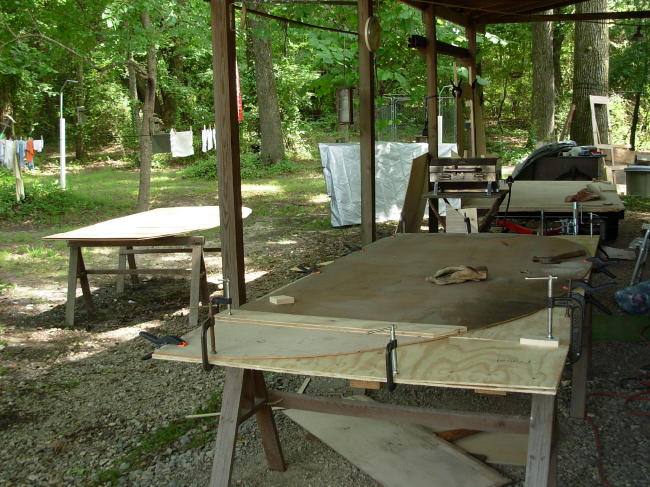

A couple of sturdy saw horses, a few straight 2x4's, & a couple of sheets of plywood or OSB & you've got a large flat surface - Here's my right side wall laid out on a few 2x's (after assembly on the 'flat' surface), clamped & weighted while the Titebond-II dries -
Once the glue has dried you have a pretty sturdy assembly. Here I'm applying stain to the same sidewall, you can see the left wall already set in place temporarily in the background
Plywood 'pattern' laying on my 'flat' surface

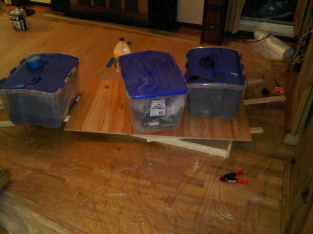

Postby tcolar » Tue Aug 10, 2010 10:30 pm
My garage floor is not flat at all ... the trailer not too bad but not perfect.
so what i'm doing now is i laid down plastic on my living room floor (flat hardwood floor) and gotta glue the main frame elements to one skin there to get a nice square frame ... then once set will move it to the trailer floor to finish it.
I think it's my safest bet to get a straight wall .

Postby tcolar » Tue Aug 10, 2010 10:56 pm
Starting like this:
