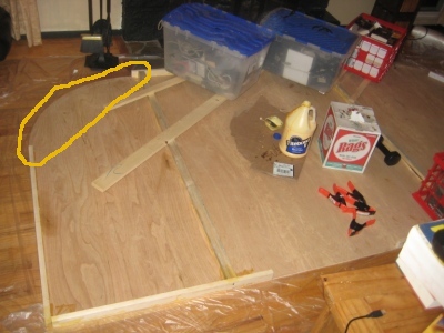

How should I frame frame my wall radius (highlighted area):
1) Should i cut couple of radius shapes ("arches") out of 3/4 ply and glue them together (to get 1 1/2 '') ... somewhat lots of work.
2)Make a "rough" radius using small pieces of 2x1 .. later fill the gaps with putty or exp foam ...
Other ?
Thanks.

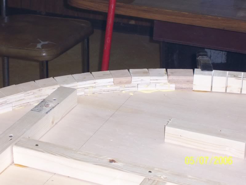

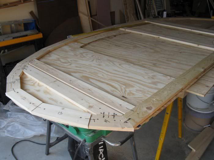

Postby len19070 » Thu Aug 12, 2010 7:58 am
I've used this method a handful of times and it works well for me.
These photos are on a Stick built insulated wall but I have also done it on a solid plywood wall.
It worked out well on the nailers for the ceiling panel.

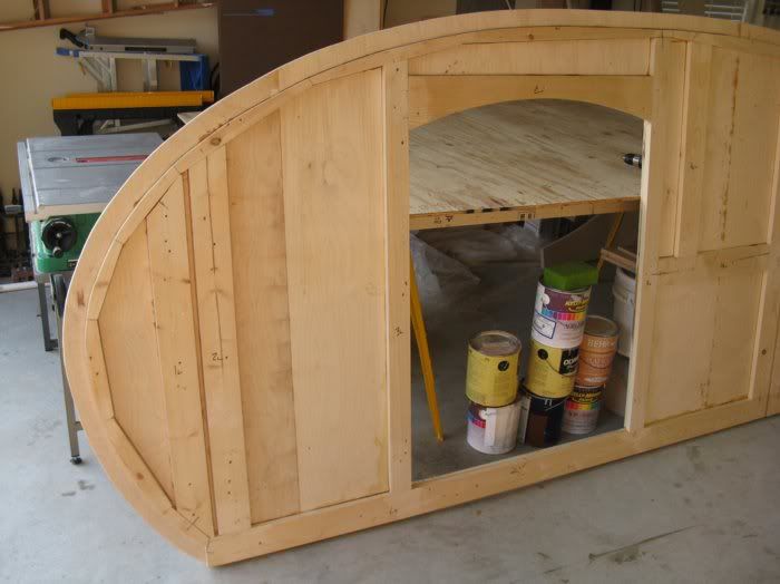

Postby Juneaudave » Thu Aug 12, 2010 8:37 am
I did it two ways...a solid steamed and laminated outside and a kerfed inside. The space between the two was used to slide in the headliner.

Postby GPW » Thu Aug 12, 2010 8:51 am
JDave , that's pretty slick !!! ...also allows you to add the inner paneling and then just route in the groove for an exact fit .... very COOL !!! 8) 8) 8)
You can easily see where the laminated strip provides more wood for better strength ... the kerfed wood is only thick as the uncut wood , the rest is just dead weight/gluing surface ... I sometimes obsess about getting the maximum strength into a project , the little things being very important in the overall strength of the build ... Laminated is definitely the best way to go .... thin wood bends easily , and when fixed together , retains that shape ... Twice as thick is eight times as strong !!! :thinking:
